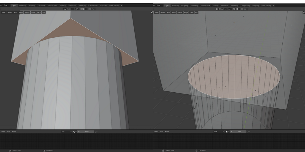

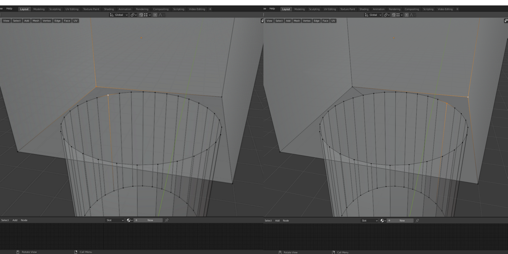

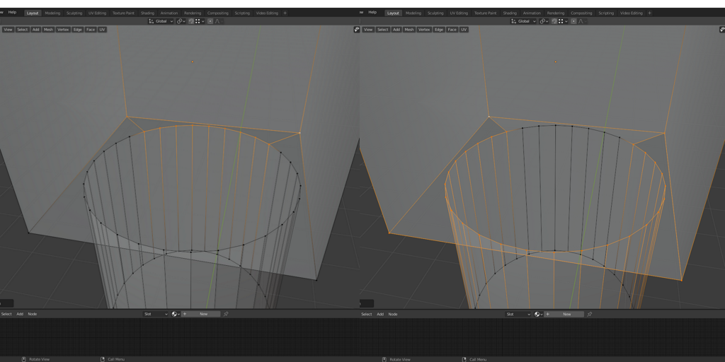

    after snapping the cylinder to the cube, you need to delete the top face of the cylinder and the bottom face of the cube,
    then connect a vert on the cube to one closest on the cylinder, then again for another vert.
     then you can fill the faces.

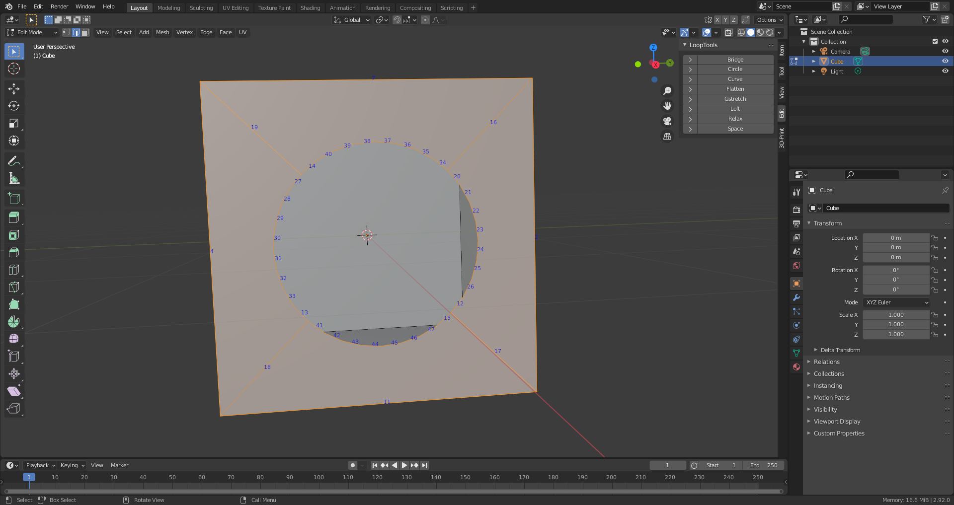

    ssketchmore here is an alternative (not necessarily better!) way of doing this (I only show the bottom Face of the Cube here):
    Where I use the W hotkey (Right Click Select), you might need to right click beside the Mesh to bring up the Specials Menu (Left Click Select) and LoopTools (you need to enable that Addon!) is also in the Specials Menu.
    Like I said, not because it is better, but it is good to have different techniques available ;)

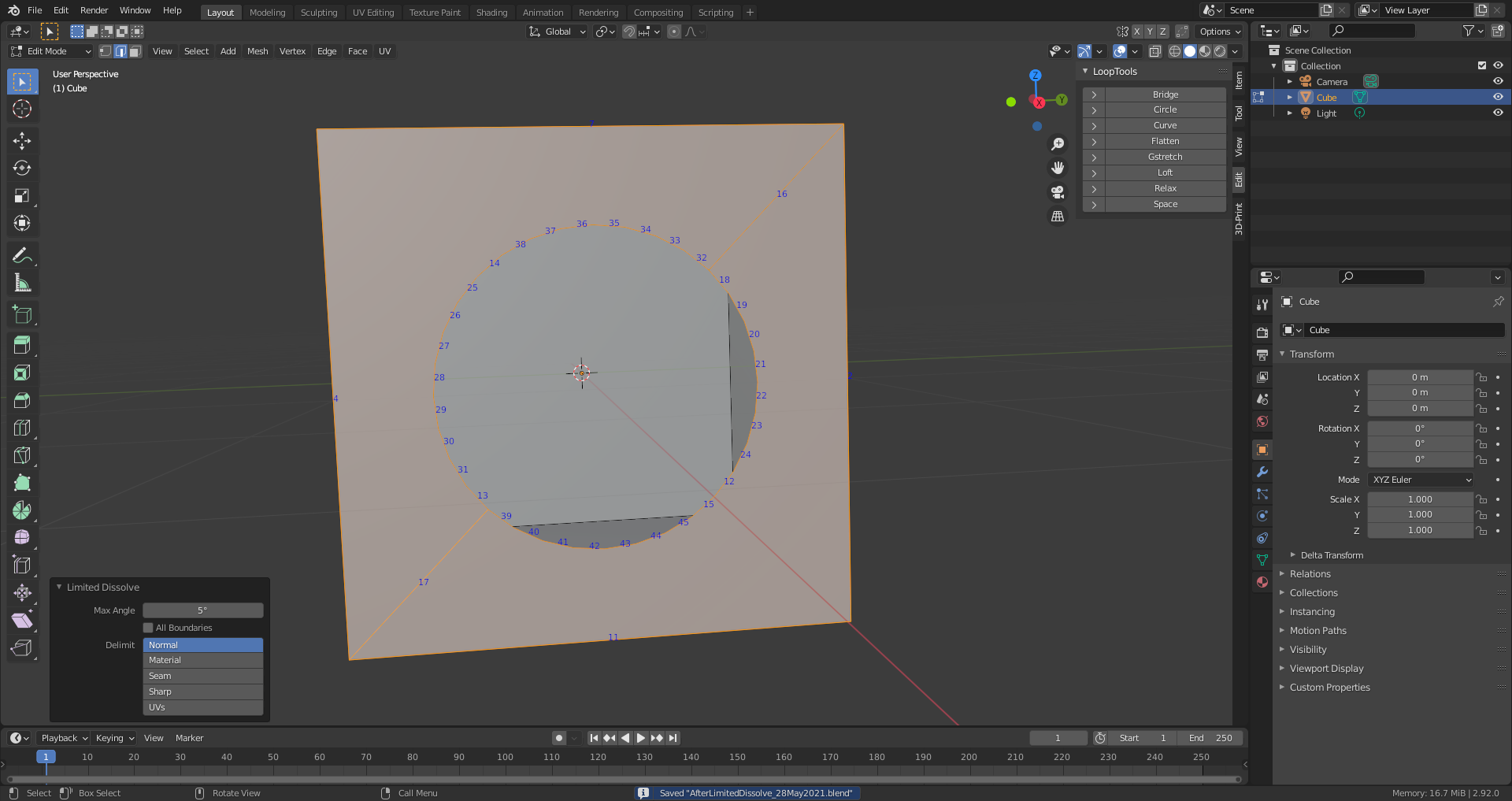

    spikeyxxx I'm wondering why the "Limited Dissolve" operation is working like this with the default settings. It looks to me a little bit arbitrary:
    duerer I have no idea how Limited Dissolve calculates what to dissolve. F9 gives some options and it somehow uses a max. Angle, but I do not know what angles that are...

    I just tried loop tools circle. I've never heard of that before. I feel it's more elegant because we don't need to select every vertex and fill repeatedly. Thank you so much.
