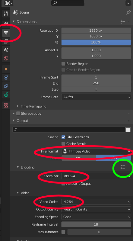

    Once you finish compositing you will need to render an animation.
    For an mp4 video, go to the output properties, under output select FFmpeg Video as the file format, then under encoding select MPEG-4 for the container , then H.264 for the video codec, or you can select from the presets (green circle)
    Then render an animation , this will save to your temporary folder. if you wish to save to a specific location on your computer click the folder icon and select a location on your hard drive.
    You can then post the video any where you like.
