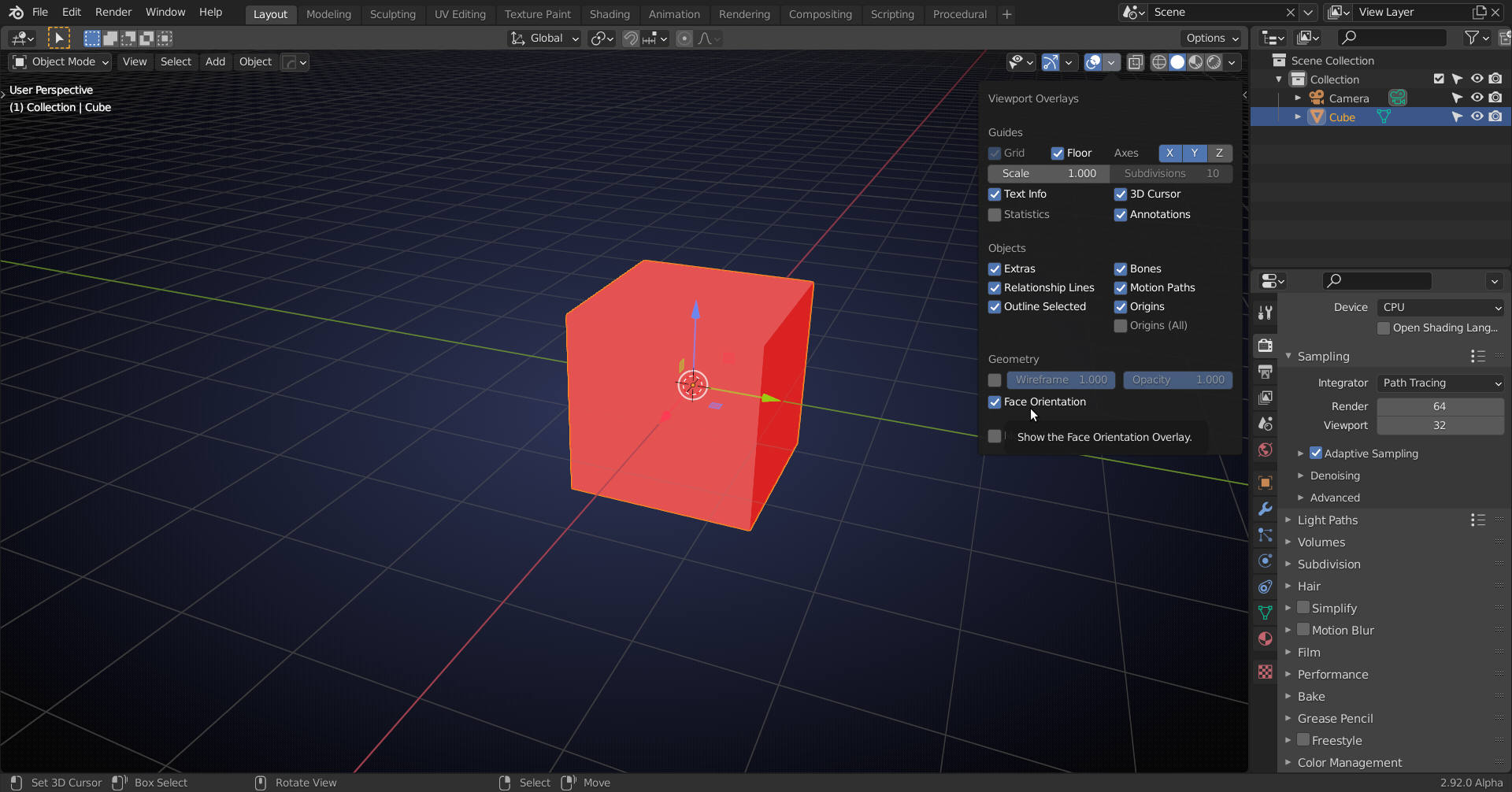

Backface Culling off:
And the same with Backface Culling:

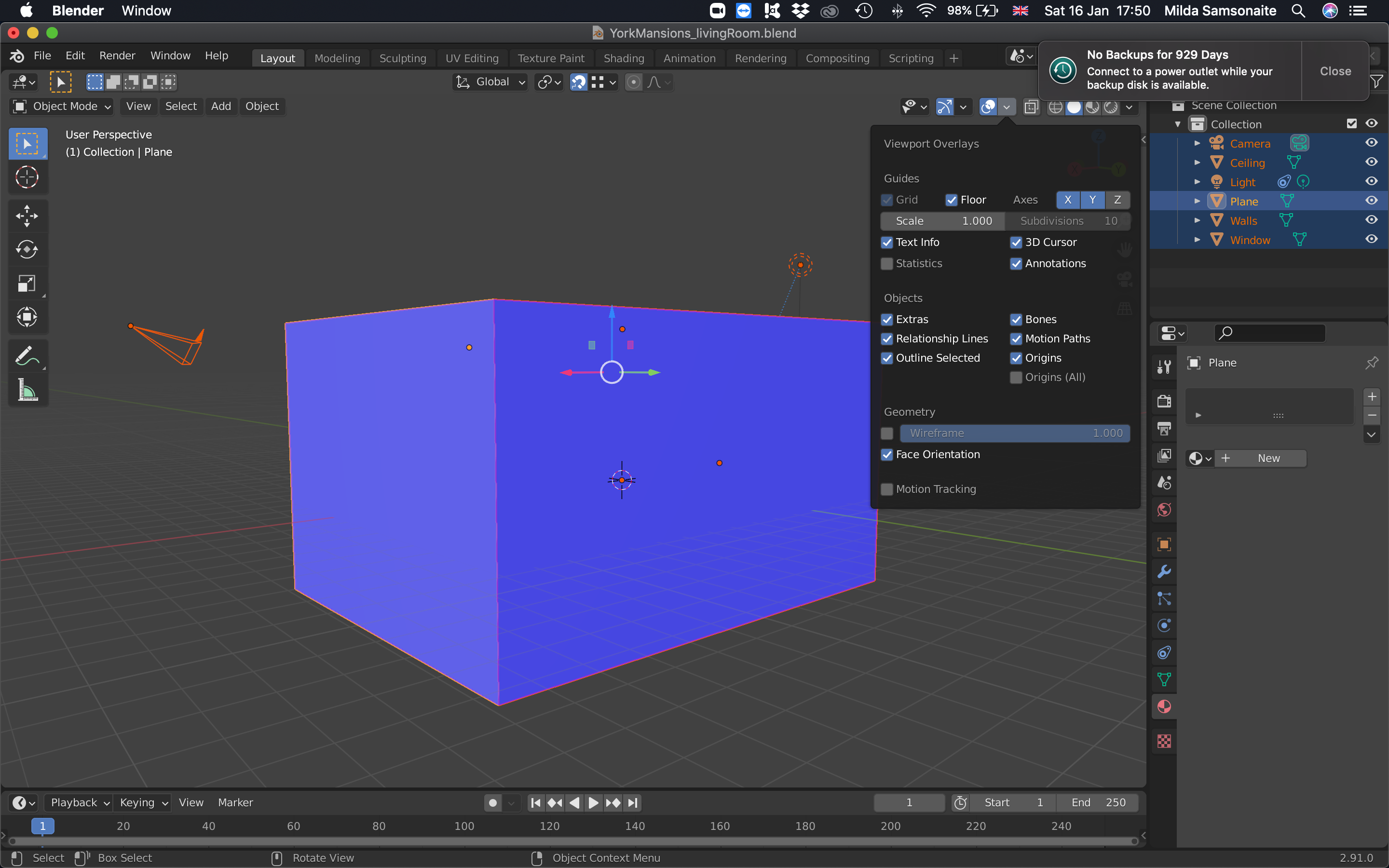

Thank you very much @spikeyxxx. I have tried to do exactly the same but it doesn't seem to work at all. Am I forgetting anything?
Right, when you enable the Face Orientation, you will see the Faces that are facing you ('front-facing') in blue and the ones that are facing away from you (meaning you see the backside of those Faces) in red.
What I did in my screenshots was turning the default Cube 'inside out'.

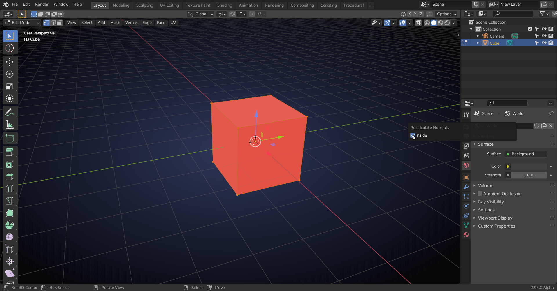

Select all in Edit Mode and press SHIFT+N:

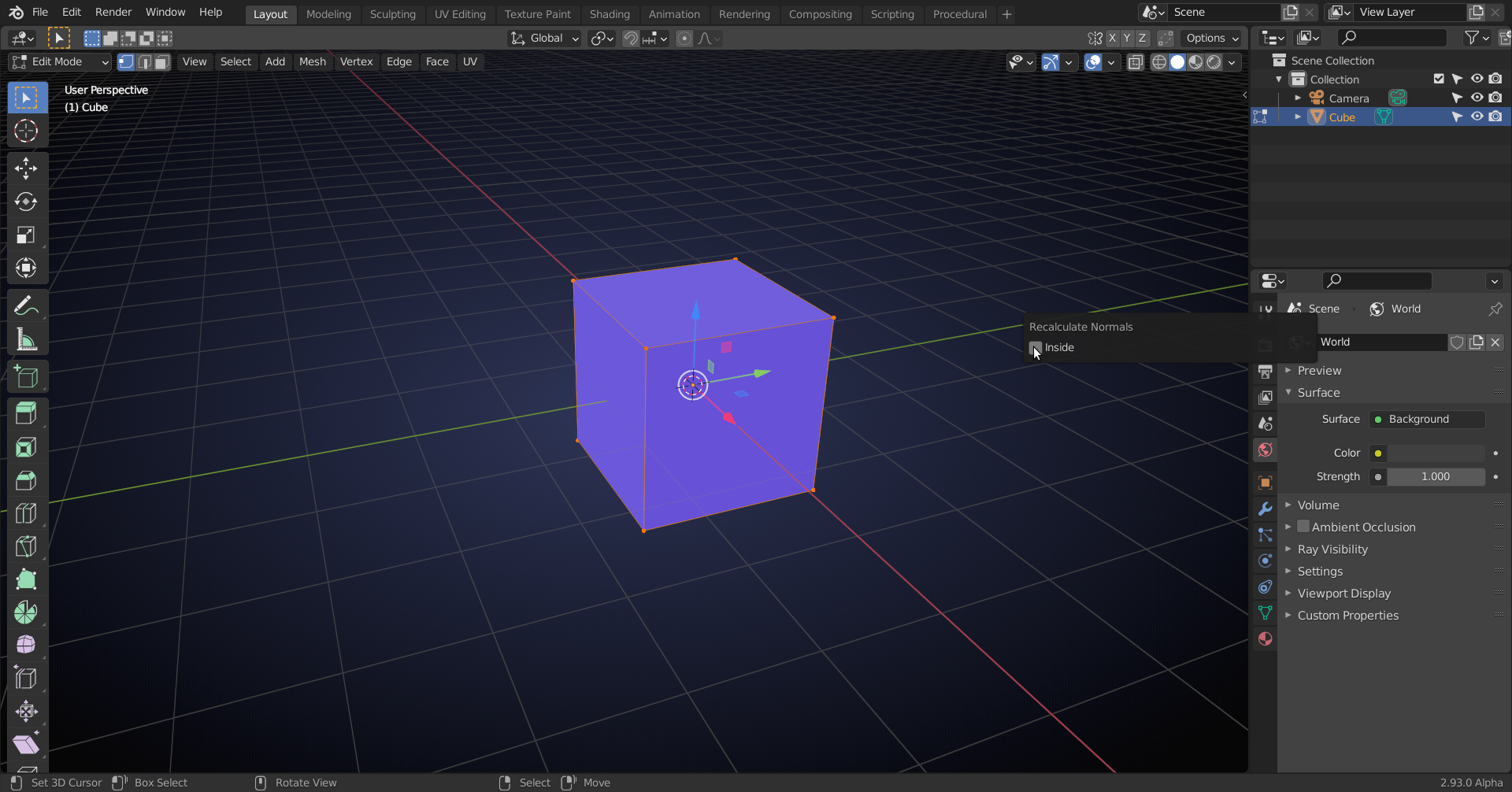

and then check 'inside' to flip the Normals:
Now you can see the effect of Backface Culling.
