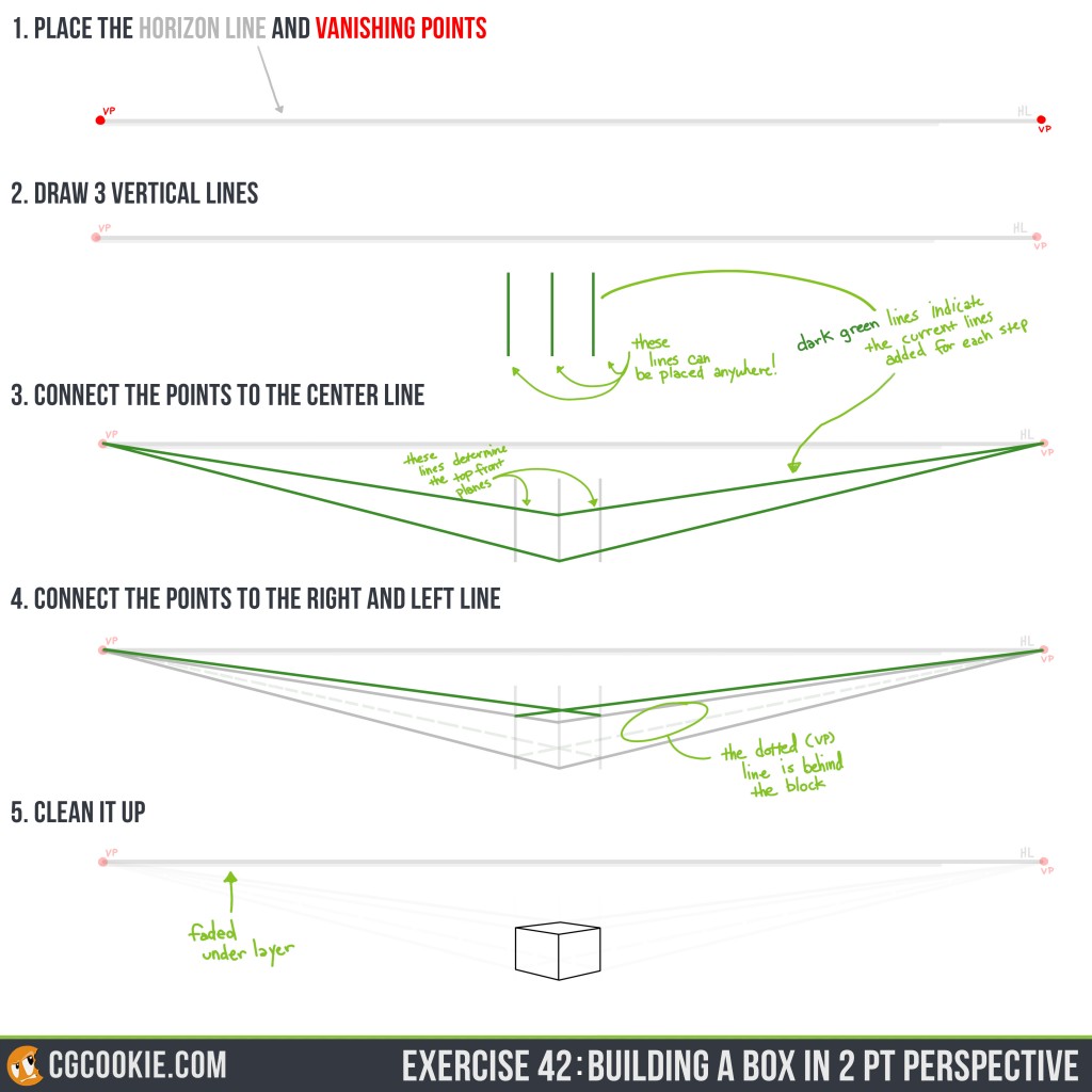

 For this exercise, I wanted to create a view of step by step  block below the horizon line. The reasoning for only creating one block for this is less confusion for you guys, and it’s the same step I use for creating blocks.  A few quick things to keep in mind when creating the blocks. Using the line tool is preferred, but you can also use the method of click on the canvas, moving to a specific destination, and holding shift down and click to create a straight line. Keep in mind if you have “transfer” or “shape dynamics” turned on for your brush, this may create a faded line. For this exercise i recommend turning off transfer and shape dynamics so that way you get a nice solid clean black line.
  Somethings to keep in mind when creating blocks:
As far as process goes this isn’t super complicated, but it’s important to keep in mind that eventually you shouldn’t need to draw the vanishing point lines (seen in dark green in step 3) and when you grow as an artist you should try and draw just the edges of the boxes by eyeballing it.
