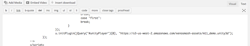

Both of these are required in order to display and properly play your game in a web platform. Players will also need to have the Unity web player installed but that is something they need to do themselves. For the HTML file you'll want to open this up in a text editor of some sort. You'll want to locate the area that has a link to the .unity3d file as this needs to be updated to the location of where you want to upload this file. It will have the name of your game followed by .unity3d. So in my case mine was called "testGame.Unity3d" and you'd need to replace that file with something like "yourwebsite.com/testGame.unity3d". Below is a screenshot of the highlighted area that you need to be looking for: UnityLinkThere are a few ways I've personally uploaded this file online:

I've tried using this with Dropbox and have had issues personally but it may work for you. Either way you'll need to ensure you have the direct link to this file. The next step is to copy the HTML code and paste that into a page on your site. In my case I used a Wordpress site and pasted the code directly into a post. If you go this route make sure you're in text mode and not visual as it may cause issues with formatting. Paste the code in and change the link. Depending on the height/width you selected for your player you may need to adjust this to fit within your site. The good news is you can change all this directly from the HTML code. If all went well you should be able to see this player within your site now, hooray!
