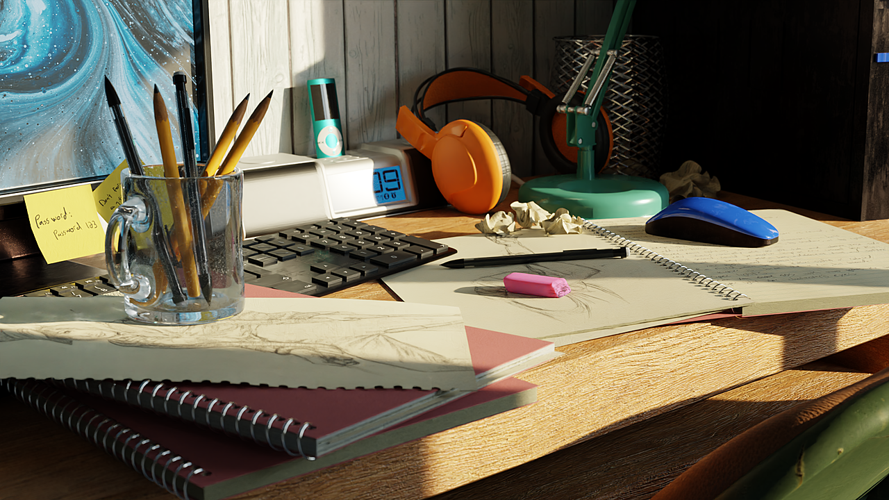

This is an exercise submission on the exercise Create Materials and Shaders for a Scene
This submission has passed!
  • crew
    Jonathan Lampel (jlampel)
    Wow, this is a great result! I can tell you've paid a lot of attention to detail. My only nit-picky critiques would be that the bump on the desk and chair is a little bit too strong. The wood texture on the wall does look a bit fake with the lack of depth, but in a way that looks like wallpaper so it still ends up working in a way. Awesome awesome job overall. Keep up the good work!
  • Matthew Fricker (frikkr)
    The glass shader is lovely and the overall feel works really well. Great work with lots of attention to detail!
  • crew
    Adrian Bellworthy (adrian2301)
    Excellent work, I love the texture on the wall, the glass looks great. well done 👍
