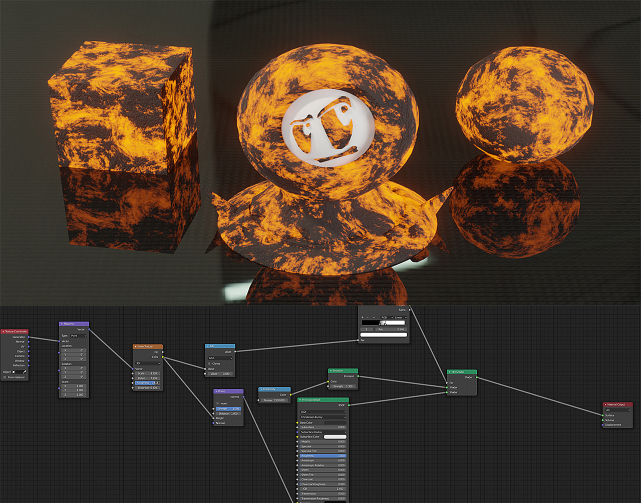

This is an exercise submission on the exercise Create a Procedural Lava Shader
This submission has passed!

    It is definitely challenging! Don't worry though, it'll come with practice :)
  • Matthew Fricker (frikkr)
    Very nice , maybe intensify the emission a bit and add some colour variation to the lava? Great work!
  • tasosn
    adrian2301  Yes, the truth is that it was very difficult for me. I find it very difficult to think Which node should go where And why without someone showing it to me when I see it I understand but I find it difficult to make it. I think for me, ιt is the most difficult part in blender.  btw thnx for your feedback
  • crew
    Adrian Bellworthy (adrian2301)
    Hey ttasosn , this exercise is really difficult. Your result actually looks pretty good, maybe some glow on the lava is needed. Check out the Shader Forge Course for a variety of materials to help you learn the complexity of shaders. The best way to learn anything is to try and practice, and you will succeed. 👍
