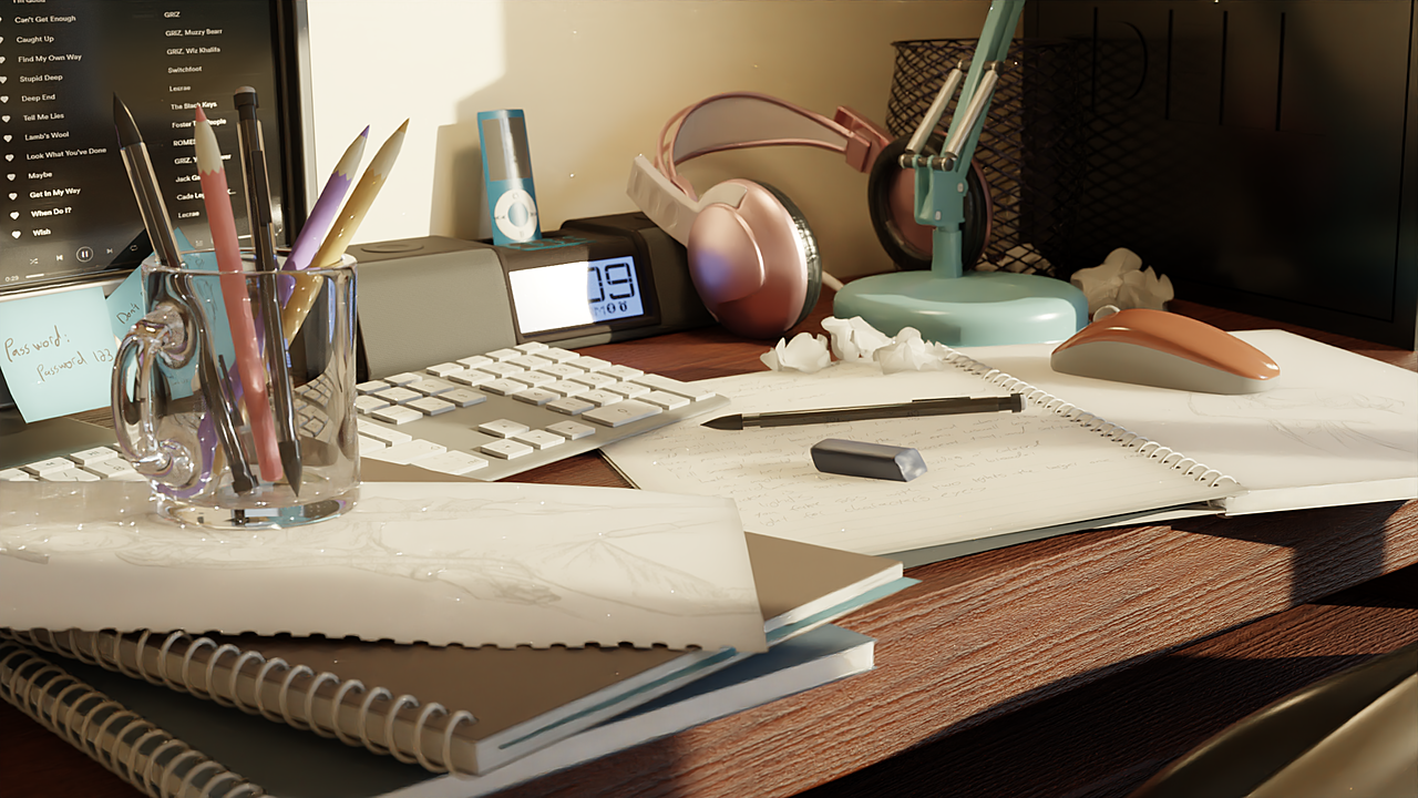

This is an exercise submission on the exercise Create Materials and Shaders for a Scene
This submission has passed!

    Jonathan Lampel (jlampel)
    This is awesome, nice work ddylh ! In only have a couple points of feedback:
    The wood texture looks a bit big, so it sort of throws the scale of the scene off a bit.
    Any surface that is a single color that looks a bit fake (like Matthew mentioned) could use a roughness texture to help make it look less uniform.
    Hope that helps and keep up the good work!

  • dylh
    Ah thanks Matthew! Yeah totally get what you mean, the mouse shading is my least favourite ... I think maybe the gloss is too extreme or it needs some texture 🤔 and great advice about the pencils, will look at that also, thank you!
  • Matthew Fricker (frikkr)
    Great effort! The headphones look great and overall it looks very real. The mouse seems a bit fake to me , but I'm not sure why , and I think the wooden tips of the pencils need to be darker and rougher to look more like they have been sharpened. Overall great though!
